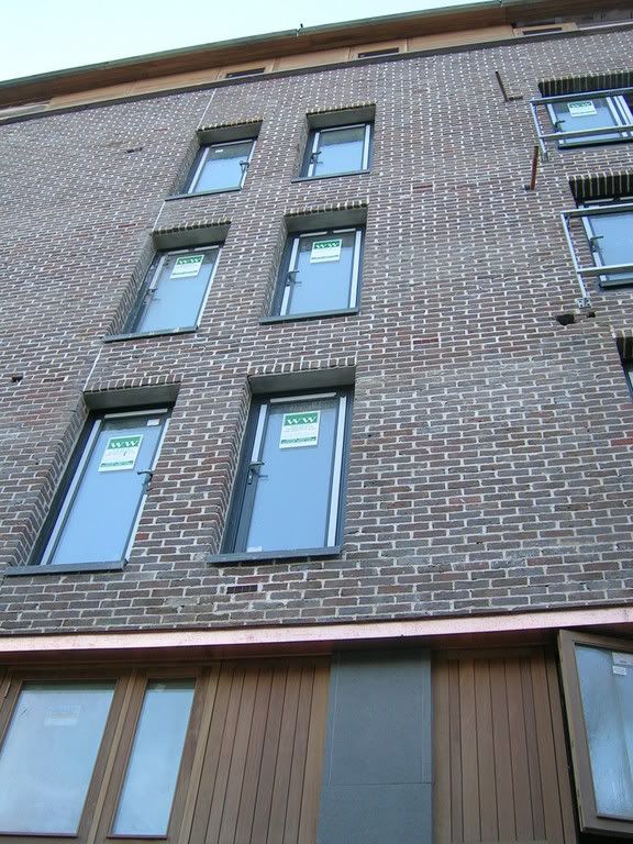

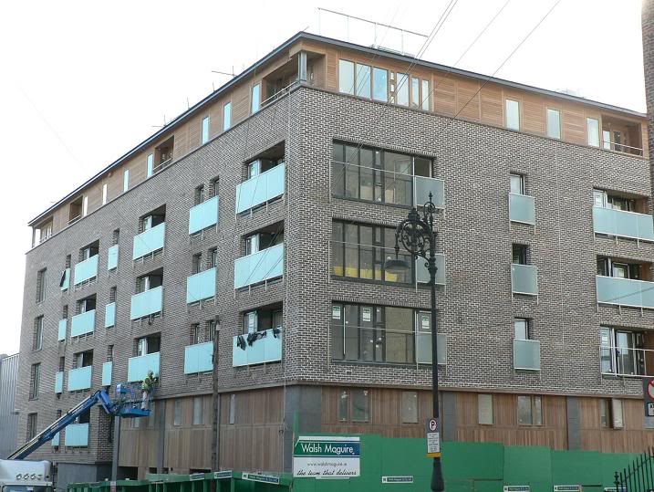

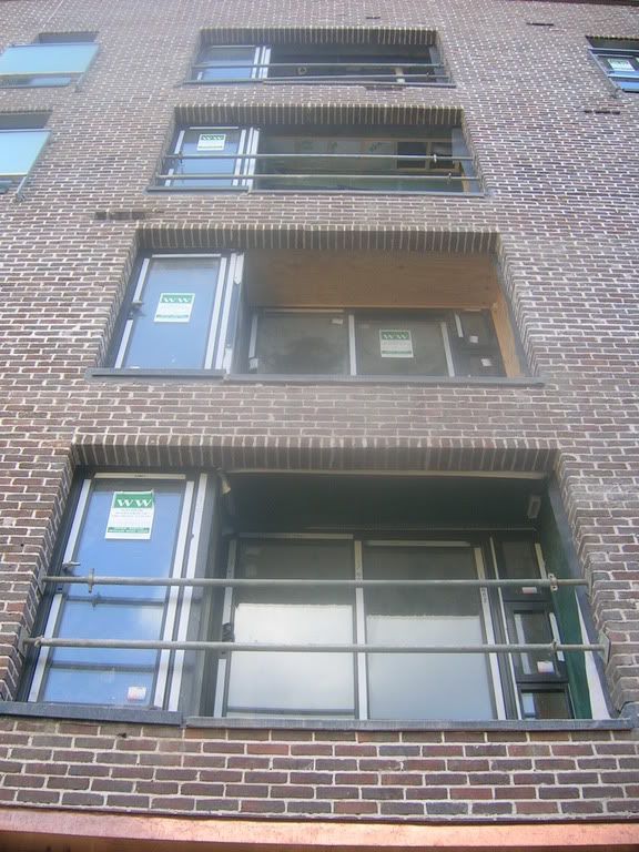

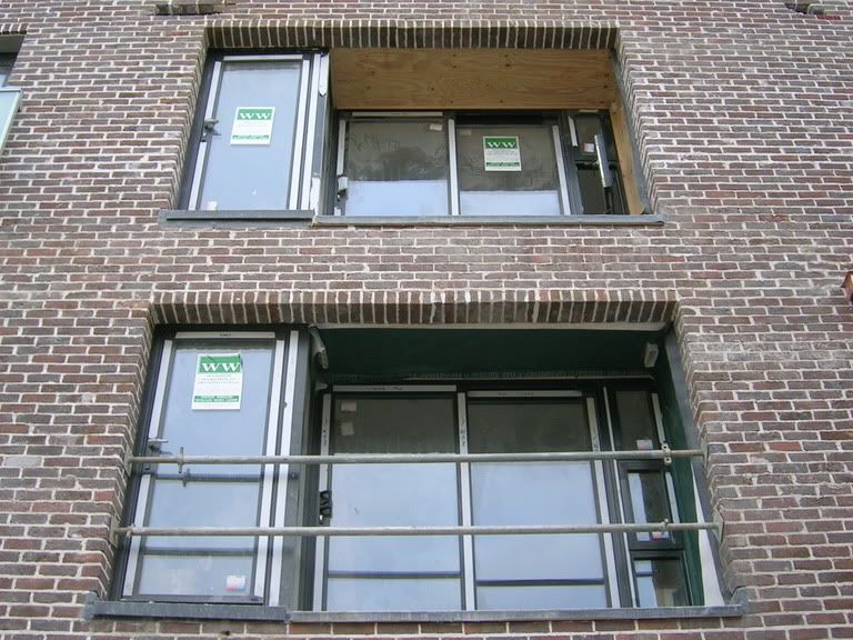

Has anyone got any thoughts or opinions about the ongoing development at the junction of Henrietta & Bolton St? I was home over the Christmas & went up for a visit. Apart from the bland design, I thought the quality of the materials & workmanship were incredibly poor.
I’m beginning to wonder whether PP was actually granted! Shoddy workmanship, that’s what it is. Shoddy, shoddy, shoddy…I’m astonished that DCC have allowed such a damaging addition to such an important street, and that it is being erected in such a happy-go-lucky manner adds insult to injury.
The brickwork, bonding pattern, mortar, windows…all have major flaws in them and the overall effect certainly makes for uncomfortable viewing…
What? You mean you dont like the telefone box onthe roof, capping it off? All things considered, a cringeworthy job that is all the more bizarre when you consider that the H St is the oldest planned Georgian st in the city 😮

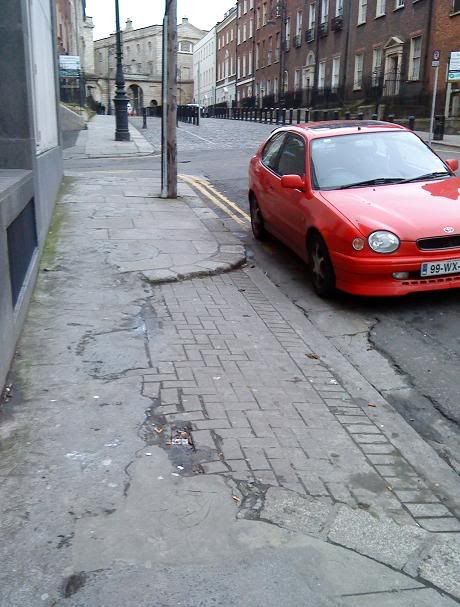

ParticipantThe condition of Henrietta St is a disgrace as is the condition of most of the Georgian Northside. Is any one awayre of any plans to regenerate these areas?

ParticipantI agree with you on most parts. The building sticks out like a sore thumb. I see it all the time and sigh.
“The brickwork, bonding pattern, mortar, windows…all have major flaws in them and the overall effect certainly makes for uncomfortable viewing…”
Agree with you in most aspects. For example the mortar joints appear too big, but it might just appear that way because the mortar is such a bright shade. Either way, bright or wide, looks awful.

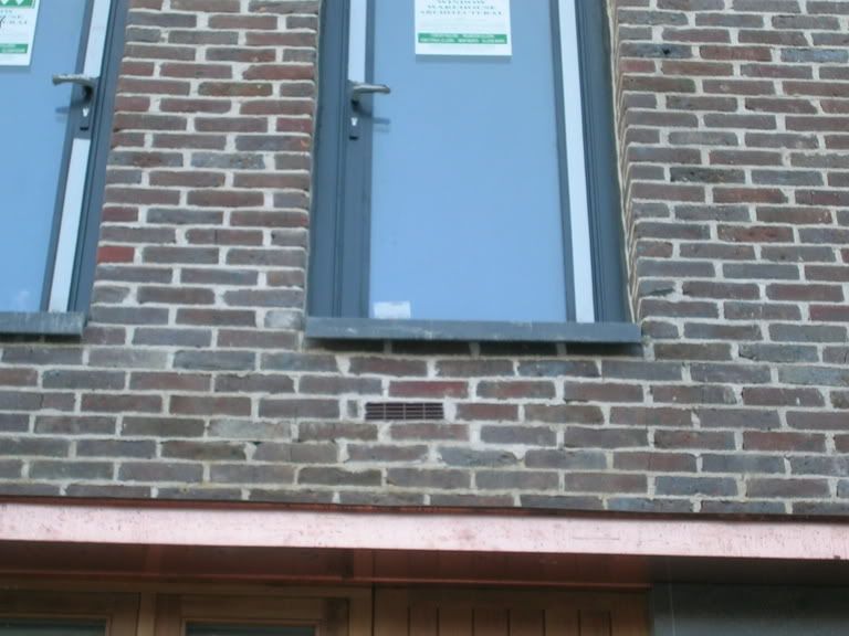

But I was wondering what problem do you have with the bonding? Its completly standard.February 20, 2006 at 6:39 pm #775221DJM

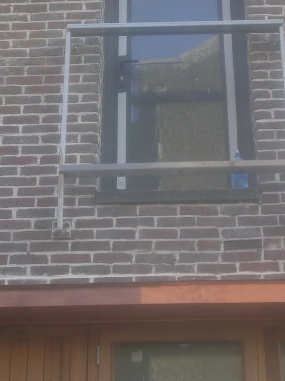

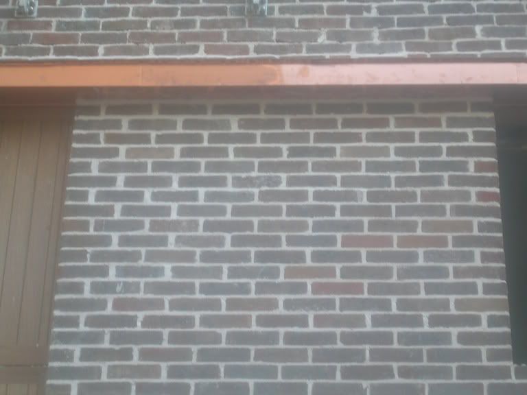

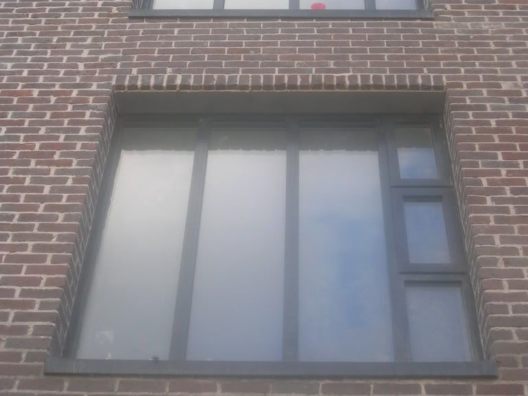

ParticipantThere’s a number of problems with the bonding:
If you look closely, the vertical joints between units vary between c.10mm & c.30mm throughout the facade.
Sorry Bren88, I should have made myself clearer, rather than the bonding pattern itself, my gripe is with the way the integrated airvents have been installed on differing courses for individual floors and break the bonding pattern unnecessarily – a 215mm airvent should only displace one brick whereas here generally, two have been cut and the vent slapped in the middle. A blatant budget job at the expense of the street.
Are the bricks reclaimed material? There’re a lot of cracks, chips & mortar staining on them, and the mortar has been very sloppily applied.
The 2 piece window sills in the widest openings look awful, are inconsistant in form if you look up from one floor to the next, and appear to be slightly askew.
I know it’s all a bit pedantic, but I don’t think there’s any credible excuse for such poor workmanship.

February 21, 2006 at 12:59 am #775222GrahamH

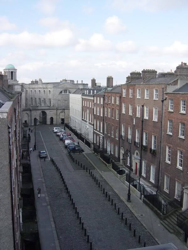

ParticipantUnfortunately I’d have to agree – the building simply is not of an acceptable standard for such an important site.
As can be seen in the pictures below, both the design and build quality is not up to scratch.The two big problems are the height of the building which is massively overscaled at the southern end, and secondly the balconies which are quite appalling: in their own right but especially when seen against the adjoining Georgian streetscape. Cheap and stuck-on in appearance, they lack any substance or permanence, a silly chic distraction on what ought to be a robust, solid facade. They also act to conceal the eyes of the building, like some ignoramus speaking to you with sunglasses on. The corner is not adequately addressed at all, nor is due deference given to the fact that this is the entrance to a street, let alone one of Dublin’s prinicpal streets.
The brick itself is very attractive: a good choice I think, as well as the white mortar were it not so sloppily applied – really a very poor job. It is ironic that many painstaking hours will be spent meticulously repointing 300 year old houses next door, yet with total control of the construction process this new-build is simply thrown up. Just look at the dodgy workmanship – it really stands out when you’re up close, especially if you’ve been scrutinising the houses of Henrietta Street as most visitors to this place do.
Most disappointing of all however is that the imposing nature of the street, sited on a steep gradient, has been partially lost. The vast bulk of this building makes no concession to its sloped environment, greedily consuming the limelight. It drains the area of its dramatic gradient, devouring the crucial ‘introductory’ slope of the street by means of its huge bulk and standard level parapet, A stepped building here would have made the world of difference. The fact that it is also too big for Bolton Street makes the permission for this scale all the more bizarre – it uses of the height of the buildings on Henretta Street as an excuse to sneakily blast pout onto Bolton Street in all its seven storey glory. It doesn’t wash.
Whilst the most of the buildings on Henrietta Street are not stepped, this building ought to be – most of the upper Georgian street is flat: it is the road leading up to it that is sloped.
The apartment building’s height to the north fits in perfectly with the neighbouring Georgian terrace at least – integrates very well. Again however, the timber yoke to the top unfortunately does not relate to the rest of the building, and it seems as though there is a roof garden being built on top to capature the views over the King’s Inns and south over the city. If it generates anything like the level of clutter that’s up there already (building materials) – oh dear…
Gardiner must be rolling in his grave at the sight of those jumpers draped over the balcony – almost in full view of his drawing room windows 😮

February 21, 2006 at 3:10 am #775224Morlan
ParticipantGod, that’s NASTY. The last pic Graham 😀 Headache or what?
I know I’m always going on about building height but this is far too bulky for that area. This is the first time I’ve seen this awful heap of crap and the first thing that came into my head was “abandoned council flats”
Here’s a photochop (if you don’t mind that I entertain myself, Graham :)) Something to look forward to…

ParticipantFlippin heck Morlan. You don’t really like it I take it?
Excellent work – rather apt that burnt umber brick is in use 🙂
But really and truly, look at those monstrous balconies both to the side and the feckity little ones tacked on to the rear:
…and that ugly timber elevation to the bottom, which is particularly poor in real life. It looks like an original undercroft space that was filled in in the 70s with cheap prefab panelling.
So very very poor 🙁

February 21, 2006 at 3:32 pm #775231Rory W
ParticipantNo point in saying it could have been worse – it’s a pile of shite – cannot believe that it was allowed in such an important position.
It looks like a prison

ParticipantAs said, the building is ‘in the style of’ deBlacam & Meagher (soft dark brick & lime mortar pointing, timber panelling, undercut at the front), but has none of the sensitivity of their work. It is a greedy monolithic building. A building here so obviously needed to follow the scale of Bolton Street and so maintain the scale hierarchy between Bolton Street and Henrietta Street.
The passage of the building through the planning process was highly suspect. As you might expect, there had been objections to it from residents of Henrietta Street and other groups, but there was a series of planning applications lodged for it (some invalid), and in the confusion one of them received no objections and was granted by Dublin City Council, so that was that; there could be no appeal.
The sickening thing is DCC knew there had been earlier objections to it so there was a much greater onus on them to get it right (given that there were no objections in on this one & could be no appeal). It shows you that they will grant permission for almost anything … scared shitless to remove a storey. The city is stuck with this wrong building now forever, because of some stupid planner. I think that after this construction boom, questions are going to be asked about DCC decision making. You just have to look at this building and what’s happening in somewhere like Cork Street ….

In my opinion this building does take away from the terrace, only not because it is a “masterpiece” such as castle street. But because it is so very badly built. alot of people here have problems with design elements. a boyle you think they are fitting and so have tried to justified. But the BIGGEST problem is the downright bad wormanship, esp with the brick work. It is this messy work that makes the building stand out, as being an eyesore. They tried to make it plain and unnoticed but it stands out from the street completely. Walk up Kings Inn street and you will see what an eyesore it is.

ParticipantI have looked at it closely . The reason the brickwork looks this way, i suspect is because it is an attempt do it as it was done a few hundred years ago.I can’t be sure however.
To my eye the brickwork is similar to the brickwork on some of the buildings that form the terrace. perhaps i am too kind. I expect that it will weather quite well in time. Much better than number 2 across the road which looks like it’s made of shiny new orange lego bricks, although i know it to be around ten years old.
