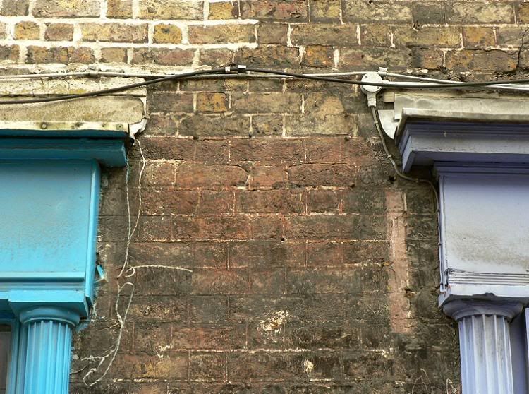

So what does this look like to you?
Is this not a fragment of original finish found in between the blue shopfront at no 82 and the red shopfront at no. 83.
Or maybe this is just another example of one of Graham's convenient 'alterations' from 'sometime later in the 19th century' ! :rolleyes:

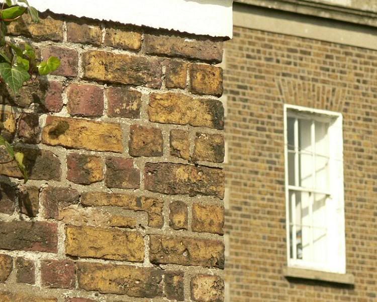

Lol. I was very precise about 19th century alterations, so shall not get drawn in on that one.
I concede the above scene paints an interesting picture. My explanation - and I'm being neither fesecious or desperate - is that a simple red colourwash was applied between the shopfronts 'sometime in the 19th century'. The colourwash has simply washed off the bricks, but has remained on the more porous and absorbant yellow mortar (it is also of such a pungent shade as to immediately suggest a wash of some kind).
This type of scrappy colourwashing would be in character with the typical human instinct - and an especially Irish one at that - to focus on improving one's own patch in a piecemeal, detached fashion, in a manner similar to other nasty practices such as painting the grubby decorative brick and terracotta piers of one's shopfront, or tacking plastic cladding over worse-for-wear elements. A quick slap of red colourwash, however incongruous, finished off with a quick repointing would tart things up nicely at pavement level.
This can clearly be seen at the next pier down, with the division between treated lower floor and non-treated upper floor directly following the cornice line.
In this instance, the colourwash was applied over both the original pointing and brick.
The other explanation for gunter's scenario is that, yes, a red mortar was used as a quick and cheap solution to improving the dirty pier at pavement level. But again, I would contend, a later alteration - and one that was confined to ground floor level.

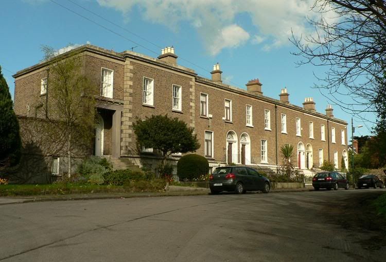

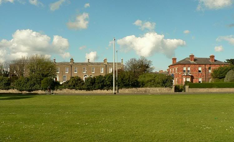

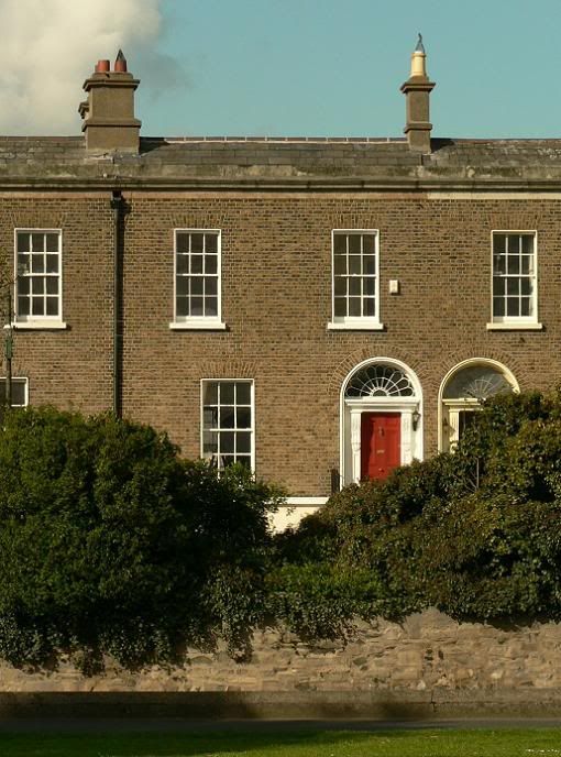

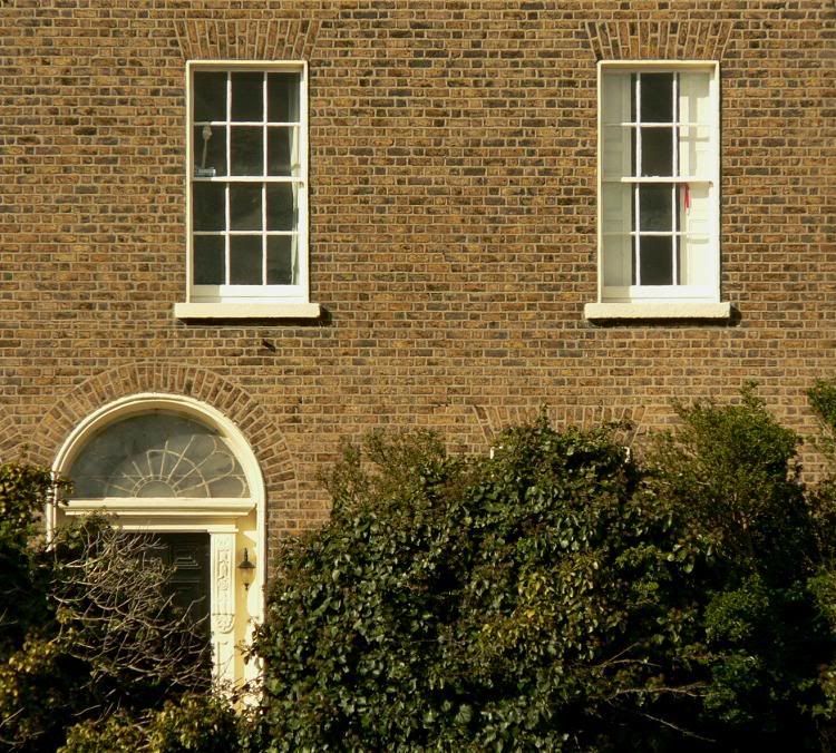

This magnificent pile of a yellow brick terrace out in Clontarf was one of the earliest speculative housing developments to be built in the seaside village. It always catches the eye when passing along the main road from behind the greenery of its own private park. The severe Grecian entrance portal of the first house is particularly striking.
The terrace stands as an interesting monument to the first tentative steps to turn Clontarf into the Rathmines of the northside: built in a late Georgian style, faced in fashionable yellow brick, and set back from the road shielded by its own park, all in a manner characteristic of contemporaneous southside housing schemes of the 1830s and 1840s.
The cornice and chimneys are so handsome - the closest Dublin ever got to Regency architecture.
Beautiful use of yellow brick.
Not a scrap of tuck pointing at this late stage.
What makes this terrace of particular interest, however, is that it also serves as a good physcial indicator of how ultimately unsuccessful Clontarf was as a residential location until the housing boom of the 1860s. There are notably no other terraces of yellow brick houses in Clontarf characteristic of the early Victorian period, with only a handful of typical seaside rendered houses in the village proper as one would expect of a small conurbation. The majority of Victorian housing in Clontarf dates from the 1860s onwards, built in machine-made red brick, and with a particular explosion in development from the 1890s onwards (as seen below for example).
If one looks closely at the yellow brick terrace, it is noticeable that it is not symmetrical, with the right-hand projecting terminating house missing as it exists on the left, as if it was never completed as intended.
Also oddly, there is only one entrance into what should be a dual-entrance development.
Look a little closer still, and it all becomes apparent.
Either this 1840s developer experienced a cash flow problem similar to his modern-day colleagues, or there just wasn't the demand for such large houses in second-rate Clontarf at this early stage.
Alternatively, gunter's ancestors sabotaged the scheme to halt the spawning of yellow brick housing on the northside.

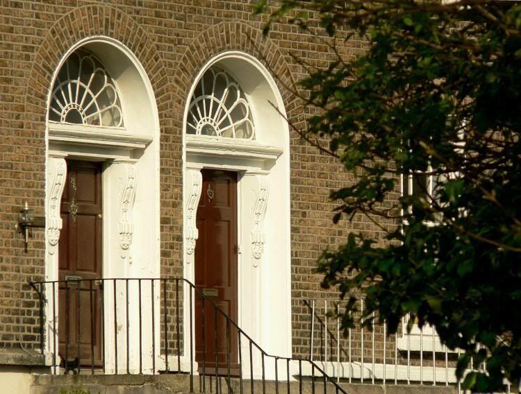

Postby GrahamH » Tue Apr 14, 2009 10:11 pm
Fight fire with fire!
Okay you've definitely got us on the Gardiner Street houses.
It was a presumption partially based on the completion of the Custom House in 1791. I doubt they're much later than 1820, having looked at them closely, but am open to correction on that. The economy of their detailing relative to their contemporaries on Fitzwilliam Street raises a smile.
Yes tuck-pointing was used on the principal facades of the vast majority of Georgian buildings. Contrary to popular belief, however, it was not a 'prestige' detail, used only on prized buildings and the houses of the extremely wealthy, as is often remarked. It was a device used out of necessity on all buildings above that of artisan level. Guaged brick was virtually unheard of in Dublin, as was pretty much the same in London I imagine, and was more associated with the Continent. Thus, tuck-pointing was a British Isles solution to a British Isles problem (with Irish, or 'bastard' tuck-pointing a variation on that again, of which more in due course).
However yellow brick as far as I'm concerned was a deliberate architectural choice, not considered a compromise, and most certainly not pointed over in red mortar. This was a later trend of the Victorians, and we all know the dangers of blindly following the trends of a society which considered the Ha'penny Bridge a blight on the city. I do concede that the harsh economic climate of post-1800 probably fuelled the popularity of the use of yellow brick in the completion of the large residential estates.

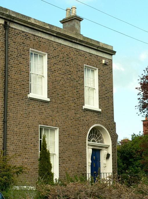

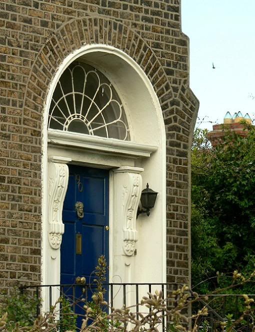

A typical Gardiner Street house of c. 1810-20 ;)
Tuck-pointing still clinging on at this late stage.
The harsh effects of battering elements on exposed upper storeys. Yikes.
And Darley's very attractive little number beside the railway bridge. It mellowed so well, as do most yellow brick buildings.
A number of parallels with the earlier Clontarf terrace.
And for what it's worth, just to show that the Clontarf development also did picturesque in addition to austerity, here's its cutsey gate lodge behind the yellow brick gate piers.

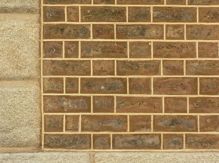

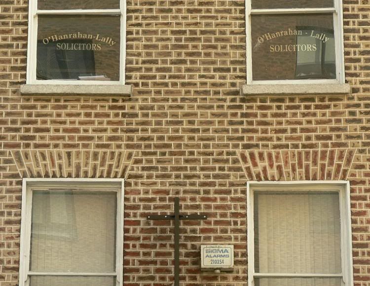

By contrast, an excellent example of yellow brick tuck-pointing occurs on this fabulous Regency building on Mayor Street.
Need the matching colour of the dark bedding mortar and the bricks, and the off-white creamy tone of the pointing be even noted...
Perfection.

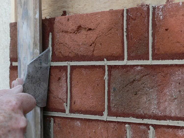

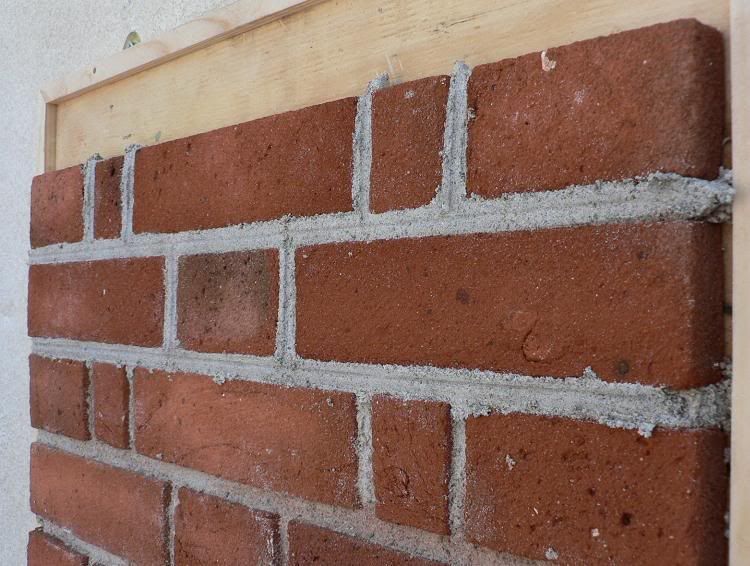

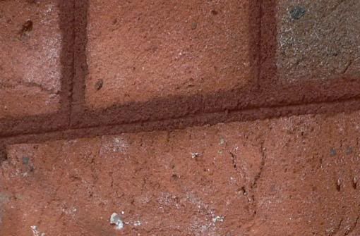

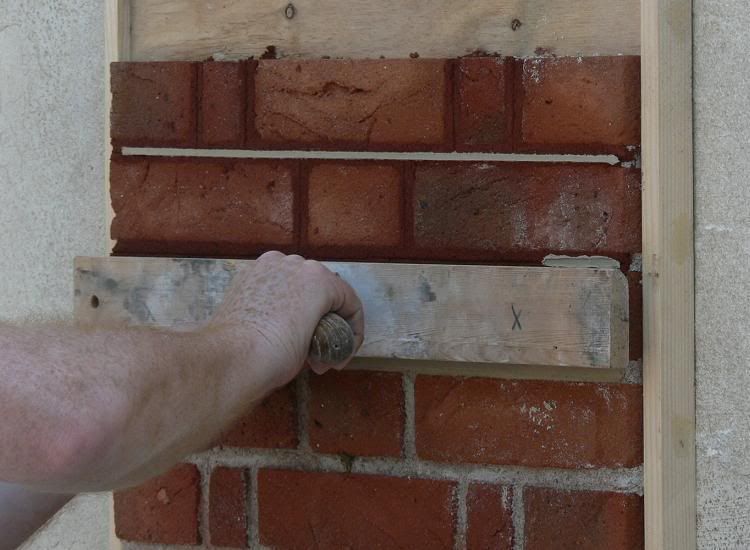

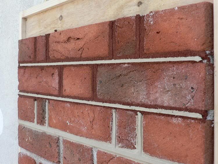

Historic Brick Pointing
Okay, so belatedly, some images showing the composition of the most common pointing techniques. These are demonstrated by Gerard Lynch, master bricklayer and brickwork consultant.
Tuck Pointing
This was the most common type of pointing used in the 18th century and early 19th century for the principal facades of brick buildings, along with the Irish variant known as 'wigging'. It came about as a result of the irregularity in shape of handmade bricks, and the desire to imitate high-quality guaged brick found in continental Europe.
It is a relatively simple technique, though requiring skill in execution. A rough bed of stopping mortar, of a colour matching the brick, is first applied into the joints.
This is then lightly grooved to receive a later ribbon of tuck putty.
Once this has been done, lines of lime putty are then carefully applied along the length of the groove, using a piece of timber as a guide.
The ribbons are then precisely trimmed of excess using a palette knife.
Vertical tucks are typically applied using a narrow putty trowel.
Again, these are carefully trimmed.

Wigging
The Irish variant, known as 'wigging' or sometimes 'bastard tuck', is perhaps unsurprisingly a cruder form. To what extent this was used over English tuck pointing (above) I'm not sure. Frankly, I'm not sure anyone really knows. Susan Roundtree is probably the best bet.
This process involved the pasting of thick courses of lime putty into the joints.
This white putty was then trimmed and moulded to create a central ribboned profile.
To either side of this ribbon, a course of coloured stopping mortar was then applied, giving roughly the same effect as tuck pointing.
The part-finished result.
Pencil Pointing
Another common technique was pencil pointing, using a fine line of white putty literally penciled into a shallow groove in the stopping mortar.
Weather-struck Pointing
Also weather-struck pointing, used commonly in the 19th century with regular machine-made brick, using a potent black putty.

at last, i was totally lost, why do you need to add the fake 'stopping mortar'
and then add wash on top of it?
why not just apply the mortar to the bare brick and do the putty second.
Posts: 566
Re: Brick
Postby Peter Fitz » Fri May 01, 2009 8:45 am
I think Graham was saying the rough bed of brick coloured mortar was added initially to conceal any irregularity in brick size, which was common.
Re: Brick
Postby lostexpectation » Fri May 01, 2009 2:16 pm
yeah but you could still do that first and putty afterwards
Posts: 566
Re: Brick
Postby Peter Fitz » Sat May 02, 2009 10:58 am
ah you mean for the 'wigging', don't get that at all myself.
Re: Brick
Postby GrahamH » Wed May 13, 2009 4:09 pm
Sorry, completely forgot about this thread :)
I'm not completely sure what either of you are talking about! If you refer to colourwash lostexpectation (as in a dye that changed the colur of the bricks), this was rarely, if ever, applied to my knowledge at construction stage. Rather this was sometimes applied many years later to spruce up the appearance of sullied brick.
As Peter says, stopping mortar was only used to conceal the irregularity of handmade bricks. Wigging refers to the Irish alternative where thin bands of stopping mortar were applied over white mortar or putty.
I'm still not sure if that answers the questions!

its seems awkward to apply the mortar after the putty
Posts: 566
Re: Brick
Postby ctesiphon » Wed May 13, 2009 10:25 pm
GrahamH wrote:I'm not completely sure what either of you are talking about! If you refer to colourwash lostexpectation (as in a dye that changed the colur of the bricks), this was rarely, if ever, applied to my knowledge at construction stage. Rather this was sometimes applied many years later to spruce up the appearance of sullied brick.
I was confused initially, but I think the question was, essentially, Why use wigging when tuck pointing is obviously better?
