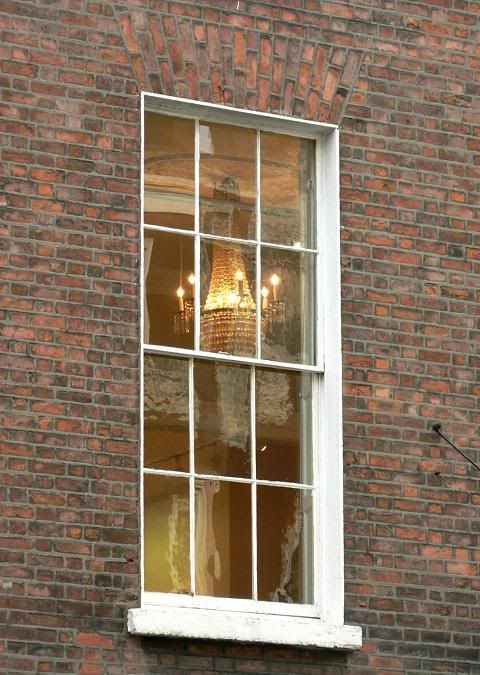

Problem with those units is they are too heavy for delicate sashes

Indeed. I'd like to see them attempting to tackle a dainty number like this.
