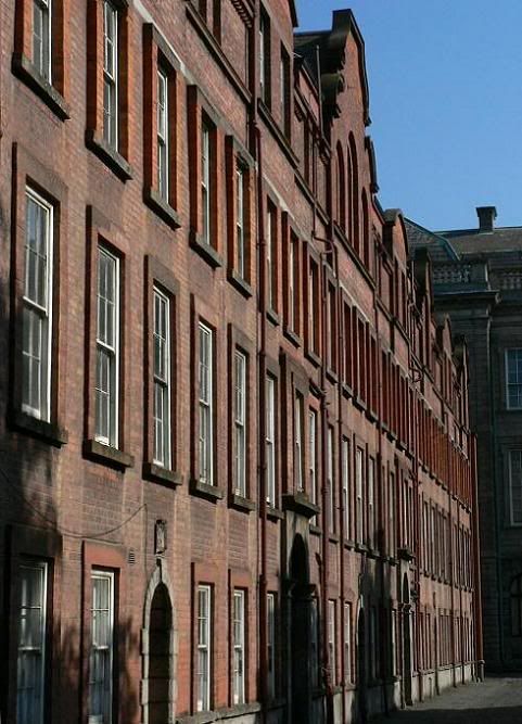

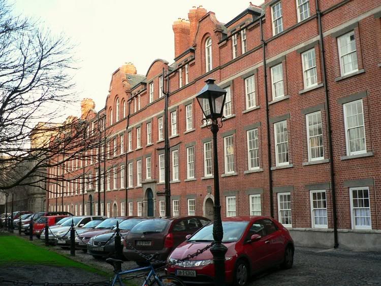

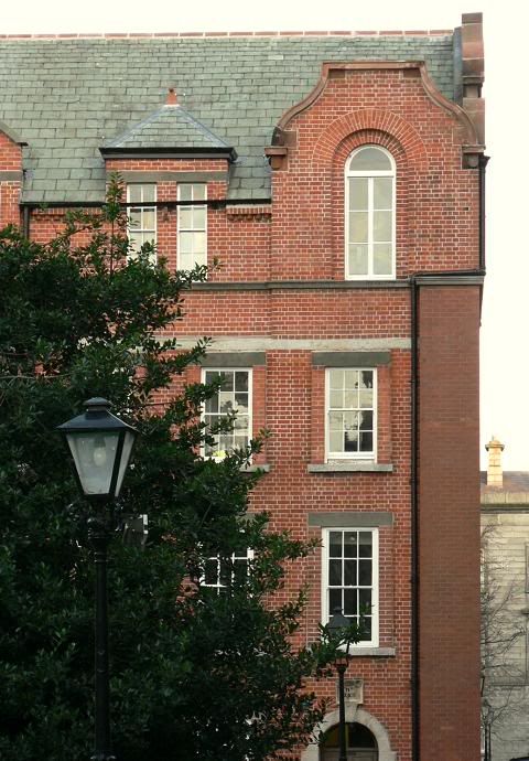

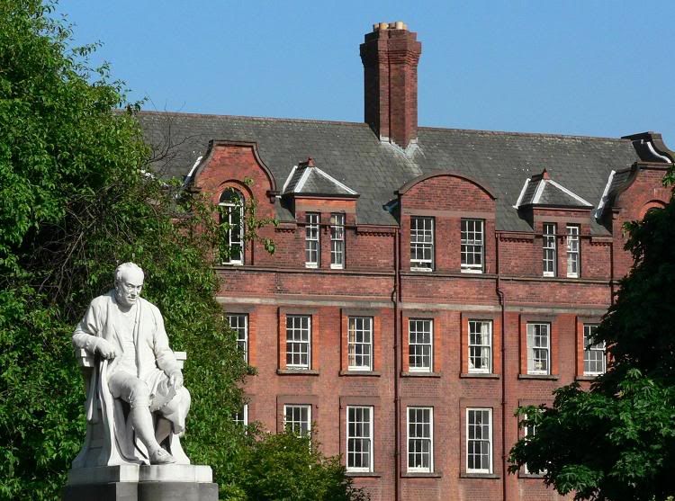

Well the Rubrics has had its shroud of scaffolding recently removed, in what must be noted as a relatively quick project turnaround of just five months. It feels like the job only started last week.
The project involved a complete rehabilitation of the exterior, ranging from reroofing, reflashing, repointing, cleaning of brickwork, replacement of decayed sandstone and terracotta elements, repair of window lintels, refurbishment of decayed windows, and restoration of rainwater goods. All the basics.
As pictured in the summer, the terrace looked grim – if nonetheless appealing.
The transformation, while fundamentally the result of conservation necessity, has greatly improved the range’s appearance.
Before
After

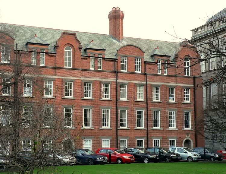

Dating from the turn of 1700, the entire range was refaced in Victorian machine-made brick in 1894, including the addition of the distinctive brick gables and chimneystacks. Therefore little of the original fabric survives to the exterior.
The Victorian brick was cleaned and repointed with a lime mortar.
While sandstone or teracotta elements were replaced where needed.
The high rendered band of skirting at ground floor level conceals a more interesting layer. This (camera phone) picture was sneakily taken behind the scaffold when works were underway. The modern (probably cement) render was temporarily removed to reveal what appears to be original red brick dating to 1700.
It’s likely the Victorians just rendered over it, and it was later replaced in cement in the 1980s. In these conservation works, the render was removed, a wire mesh applied across the whole area of old brick, and then a lime render reapplied. Presumably the wire mesh as much protects the original brick as it provides a decent gripping substrate.
Complete.
Complete.

The beautiful muddy limestone archways seen above are also almost certainly survivors from 1700 (excellent paint choice). The somewhat gawky detailing and use of sandstone dressings is characteristic of the late 17th and early 18th centuries. Sadly, the use of the native limestone-sandstone pairing rarely receives the attention of the later granite-Portland ensemble that so dominated in public construction from the second quarter of the 18th century. The former can be seen both at the Royal Hospital and at Dublin Castle (below), where Thomas Burgh’s arcade of 1712-1717 is now all that remains of the early classical rebuilding of the complex.
The similarity is striking. Did Burgh have a role in designing the Rubrics?

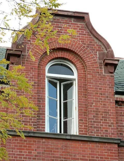

In the 1890s refacing of the Rubrics, the 1700 window opes were aggrandised with projecting reveals, with the original granite sills pragmatically retained in the centre. It seems the Victorians simply extended them in brick and rendered over the lot into unified sills. In the restoration works, all render and dodgy extensions were removed and additional granite spliced on the end of every sill.
The window lintels appear to have been rendered rather than entirely replaced. Previously they appeared to be a redish concrete composite rather than sandstone, but it was difficult to tell. I’m not entirely sure why grey render was used, but it works well.
(nice bit of cylinder glass there)

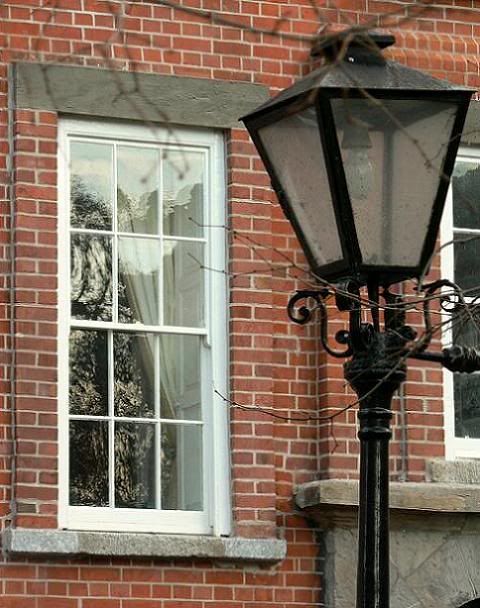

The majority of windows on the main west-facing range appear to date to the 1840s. This would tie in with a comprehensive replacement in the early 19th century, as we have seen time and time again across Dublin where old-fashioned structures of the early 1700s were updated at this time. These windows also tend to have more exposed sash boxes, further suggesting they were clumsily recycled (below). Quite a few, however, also date from the 1890s refacing.
From what I can make out, these have all been beautifully and sensitively reconditioned, with nearly all of the original glass retained.
The picturesque chimneys have also been repointed (extremely exposed up there), cleaned and the pots capped. It appears the top plinths required rebuilding, though this may have been done in the 1980s.

Graham, fantastic photographs and analysis as ever, but somebody's going to have to explain the concept of holidays to you
On the Rubricks itself, projecting brick window surrounds were an early feature, the ones at Beaulieu House (1660) and the Royal Hospital, Kilmainham, (1680) both had slight outward projections of the head of the brick surround beyond the line of the uprights, what do you make of the light coloured window surrounds in the distant early photographs of the Library Square buildings, were they rendered brickwork? (are they wide enough?), or stone?
Presumably, in the projecting window surrounds at the Rubricks, the Victorian make-over re-worked an existing feature? There must be a drawing of the original detail, or a close up photograph, somewhere!

Back to Trinity, and I suspect render may be more likely as the original reveals, gunter. They look a tad 'raw' don't they. Stone would also be rather lavish for what were modest residential ranges. I think there's quite a few other photographs of Library Square that'd be worth looking up and zooming in on - alas I don't have books to hand.
The current window surrounds of the Rubrics have always struck me as odd - so very crudely executed (as with all the brickwork for that matter), and the sandstone/concrete lintels most strange. There was clearly a precendent of some kind that informed them, as you couldn't come up with such a bizarre feature from scratch short of being somewhat derranged yourself. It seems as though they were contrived to prevent the windows being flush in the new facade, which may have been shallower than the earlier one.
Interesting also to see the same model of chimney on 'Rotten Row' above. Presumably these were added at the same time as the Rubrics was remodelled in 1894? The photograph does look earlier though...
