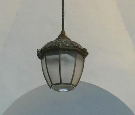

Just remembered this - Trinity's carriage arch (;)) lamp. As mentioned before, it is one of the 1930s concrete lamps!
(albeit cleaned up)
Now how did they get hold of it?!
Anyone have a picture of an older lamp here to give us an indication of when they installed it?
(albeit cleaned up)
