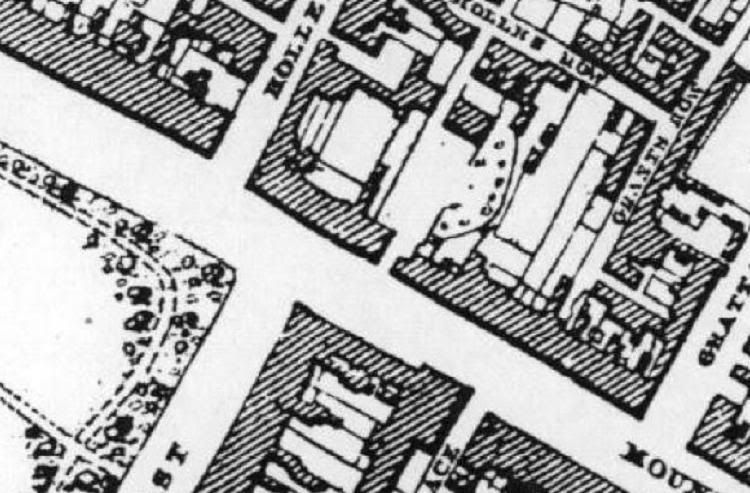

The report is also somewhat confused. Here is the 1797 map, showing what appears to be the beginnings of the buildings we have today, but it's hard to be sure. Note the clear gap in the terrace.
The later 1837 map is described in the report as having a “carriage arch and opening”, when this is clearly still a gap in the terrace.
Here it is again, more clearly, in the revised 1847 map, for which no assessment is included in the report. Again, we can see a full blown gap in the terrace, albeit with a smaller structure consuming part of the plot. The fact this is not a carriage arch can be confirmed by the archway depicted at the bottom right of the map with an X, as is standard all over the map.
So as late as 1847, there would appear to have been a gap in the terrace where the modern-day archway is, with only part of that plot covered where the door is now.

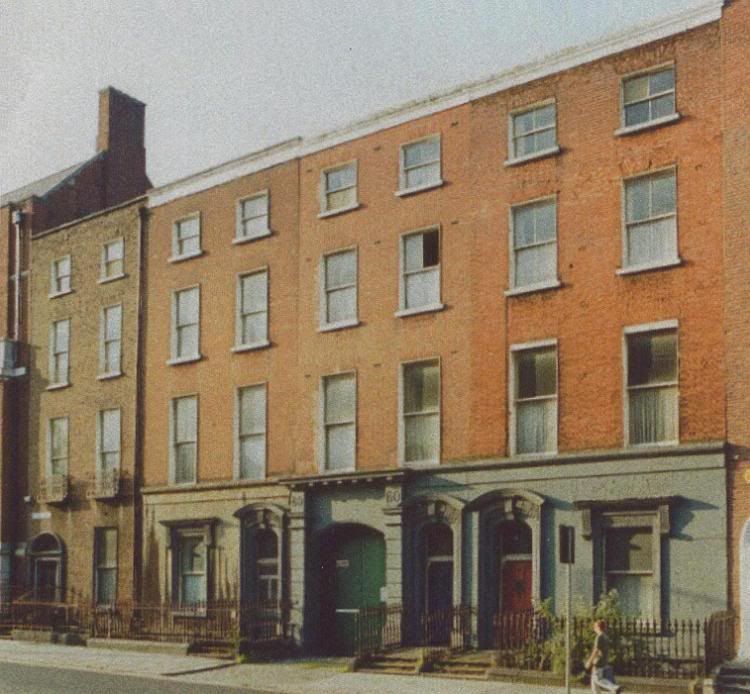

And here they are in the photograph submitted as part of the planning application.
Luckily the application for the houses’ refurbishment and modification for use as offices and consulting rooms was lodged in late 2006, before the fall in the property market. A delay of a year or so appears to have ensued, finally resulting in scaffolding being erected on site in June 2009.

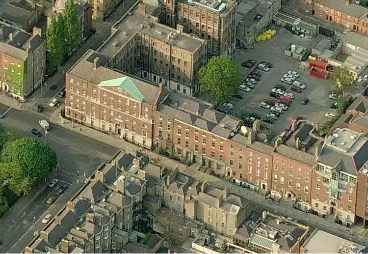

The aerial view also seems to tell us this.
As shown earlier, some time in the mid-19th century, probably c. 1855-65, the ground floors of three of the buildings were merged into what seems to have been a new commercial premises. They were adorned with the typical trappings of adaptive Victoriana, peculiar to this part of the city, with apparently Roman cement stucco dressings and render coat, as seen in places like Westland Row and Dawson Street. Handsomely and robustly detailed, they added a dash of decorative interest to proceedings without undoing the reticence of the wider streetscape. A central carriage arch and attractive cast iron railings were also added as part of the improving ensemble.

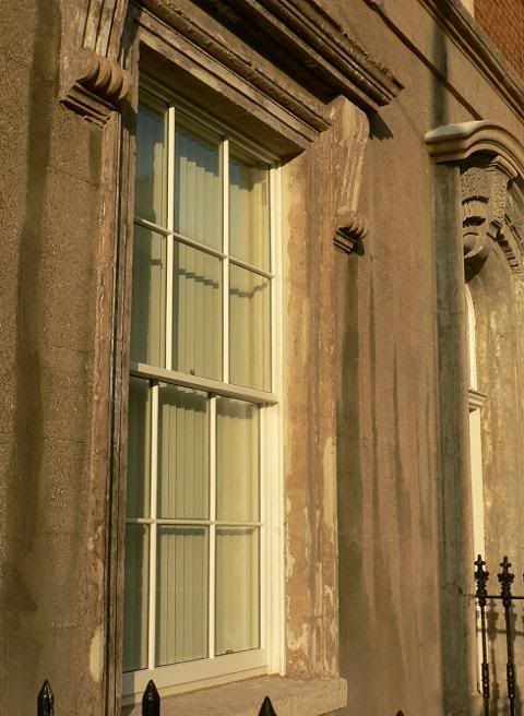

Exquisite slivers of unpainted lime render was applied to the window reveals.

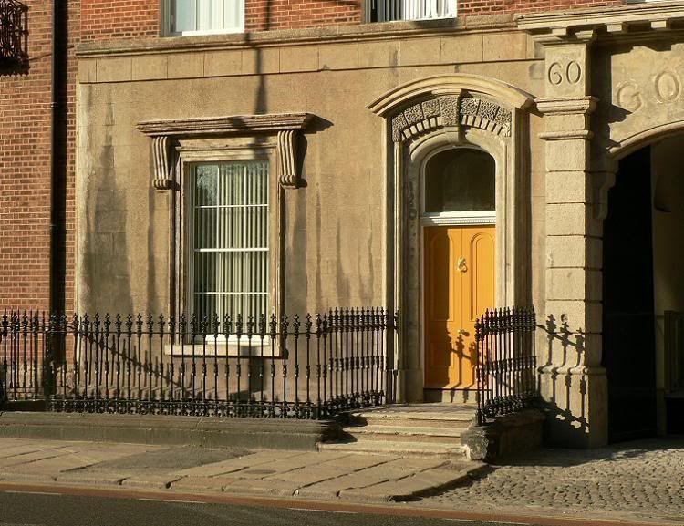

The removal of paint from the right-hand house’s shop front appears to have necessitated a renewal of its render finish.
The original surface was retained at No. 59.
Paint was also removed from the doorcase of No. 58 (and a reproduction door made in place of a blocked up window).
Some paint remains, but best not be be overly zealous. A sensitive job.

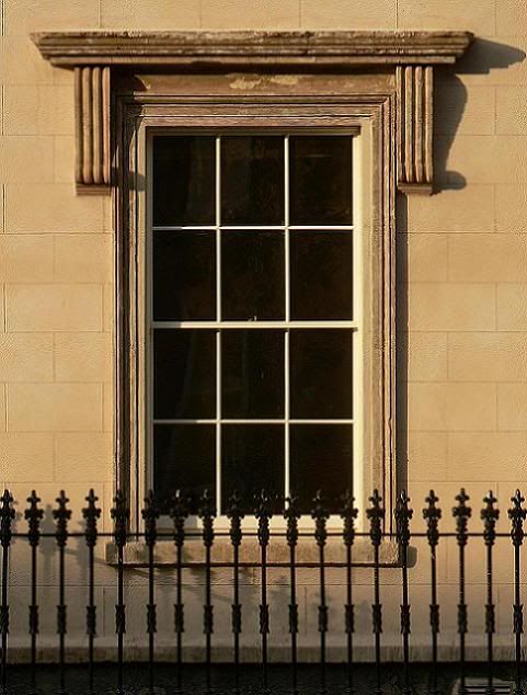

The stucco hoods look outstanding. It may be debatable if these were left unpainted originally.
Either way they're beautiful.
This complication in modification was deftly handled originally!

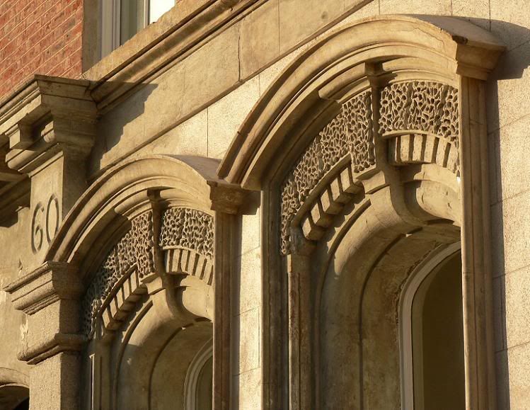

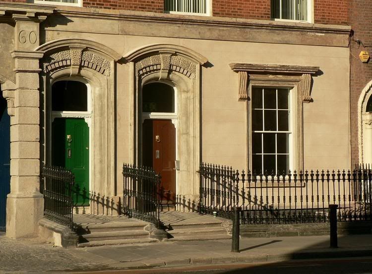

The central granite carriage arch.
We’re not told who Goff’s are – a real shame. It ain’t up to me to go looking. The doors seem to be original.

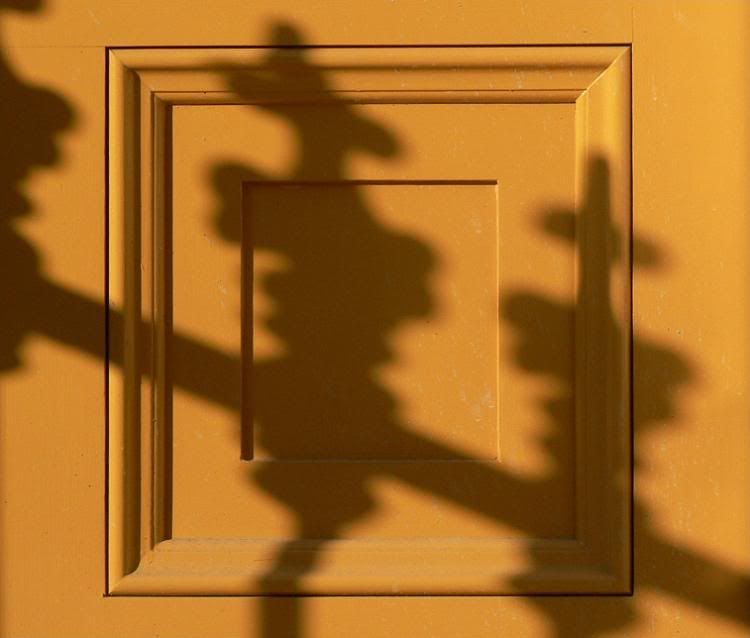

The delightful choice of paint colours lends a playful air to the otherwise stern elevations.
The mustard shade ties in nicely with the earthy tones around it too.

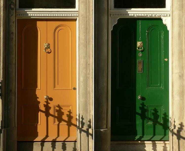

This door had been taken out in the 20th century so had to be reproduced. This comparison shows an original panel and the new one.

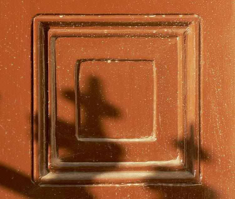

It seems to be quite accurate. Things get tricky when multiple layers of paint are involved...
Alas it’s the little things that matter. The omission of the dinky corner corbels is unnecessary.

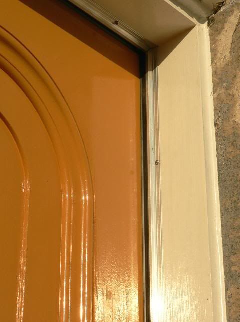

While the externally mounted draught-proofing is hardly flattering.

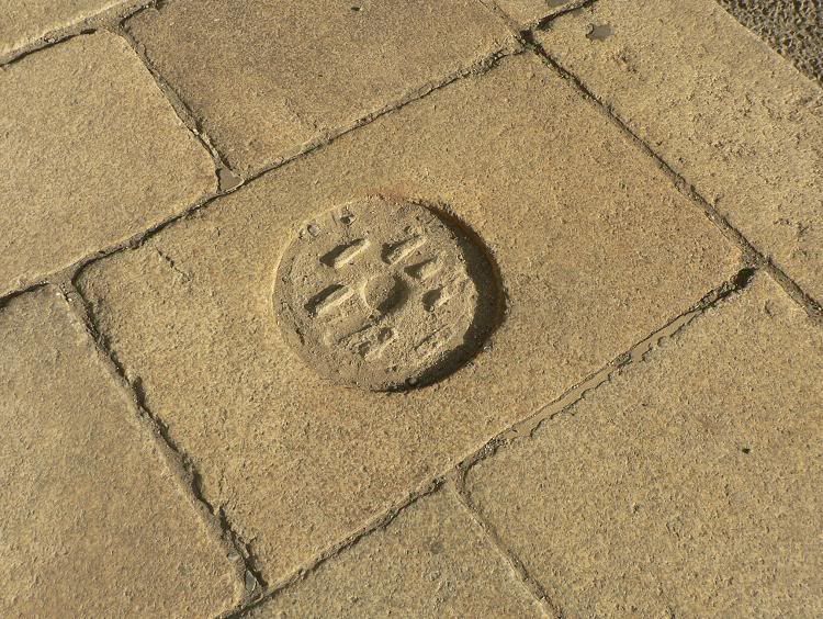

An interesting example here of where a coal chute appears to have been filled with concrete - the cover has just been mislaid.
Well preserved square diorite setts form the surface to the main entrance. A classy water cover insertion as ever.

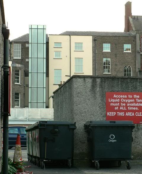

The rear, with new, independent lift shaft. Developer yellow just had to sneak in somewhere didn’t it!

GrahamH wrote:The central granite carriage arch.
Great post Graham. The focus is the horse.
"In 1925.. the company established its main offices in Dublin at Sewell & Son and Simpson's Yard in Mount Street where sales were held.."
http://www.goffs.com/about/history.htm
Also has a brief mention in Ulysses. Will post more if I find anything.
Re: Pyramid in Merrion Square
Aha! Thanks Morlan. The Horse seemed all a bit too obvious! Presumably the sales came to an abrupt end with the construction of the adjoining hospital, but you never quite know with this city...
It would appear the houses were originally adapted to accommodate livery stables or coach-related activity of some kind. Thom's of course would tell us all. An extract from Shaw's Directory of 1850 included in the historical assessment report noted some of the houses as being vacant in that year.
