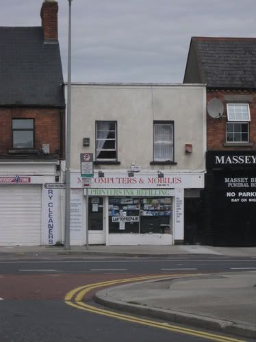

Anyway, more on topic- I saw this house on Cork Street, just opposite the junction with Ormond Street, and it set me thinking- a candidate? I don't think it's been mentioned on here before.
Low ground floor, slightly odd proportions, windows slightly closer than usual, possible removal of upper floor; and then, from Virtual Earth (just above the R110 label), it seems the roof is split in two, with one part of the plan projecting further than the other.
Maybe my eyes have been opened by this thread, or maybe my mind has been poisoned.
gunter (or anyone else, for that matter)- your thoughts?

The Cork Street house would be a possibility, the entrance door is on the right side of the facade diagonally opposite the rear return, but the return looks a little wide (could have been re-built). In a standard Billy, the return has to be narrow enough to still leave room on the rear elevation for a window to the main back room as well as the full width of the stairwell.

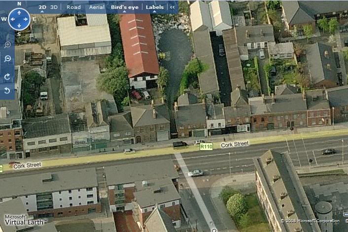

Re: 'Dutch Billys'
Had a look at the back today and sure enough, it does fit the pattern!
Rear return on the opposite side to the stairwell with window to main back room in between. Not much sign of original brickwork, but interesting remnant none the less.
