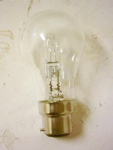

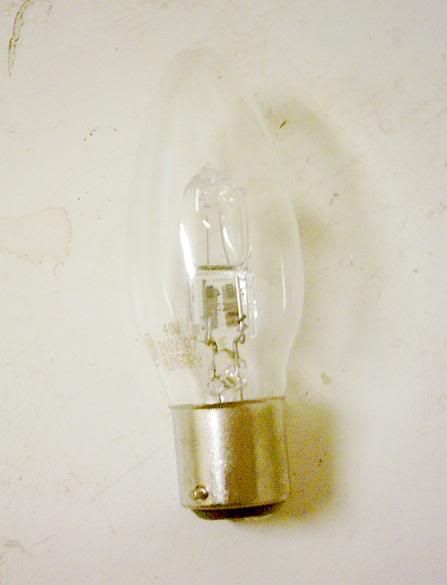

There are some LED "spot" lights included here ...
http://www.avocalite.ie/?gclid=CP-L3...FQwsOAodDx04Rg
What puzzling me is that all lamps here are "replacement" lamps - remove the old in efficient lamp and use one of these ... what I mean is that The Draft L 2007 document is requiring fittings "that take only" energy efficient lamps , presumably to take ( efficient ) lamps that will only fit these fittings . Anybody familiar with products out there ?

Again the Shelbourne also uses the above candle bulb encasing a halogen capsule to elegant effect on some exterior lanterns. Admittedly they're not quite as good as those above, featuring a plastic ring around the base, but still the only instance I've ever encountered of them in Ireland. They also last over twice as long as traditional incandescents. Why in the name of all that's sane the State isn't investing in even this basic technology that's been around since the 1960s is beyond me. As we can see, there's a host of krypton and halogen solutions on the market that are more energy efficient and aesthetically pleasing.
Furthermore, now is the ideal opportunity for that State to properly invest in its array of historic chandeliers, all of which received economising 1950s and 1960s electrifying solutions whereby bulb sockets were simply shoved directly into the candleholders, with no attempt made to recreate the lofty elegance of candles these chandeliers were designed to hold. This is done across Europe and can even lead to efficiencies with the use of miniature halogen capsules at a meagre 10-20w each. No excuses.
(traditional candle bulbs are used here but ya get the idea!)
