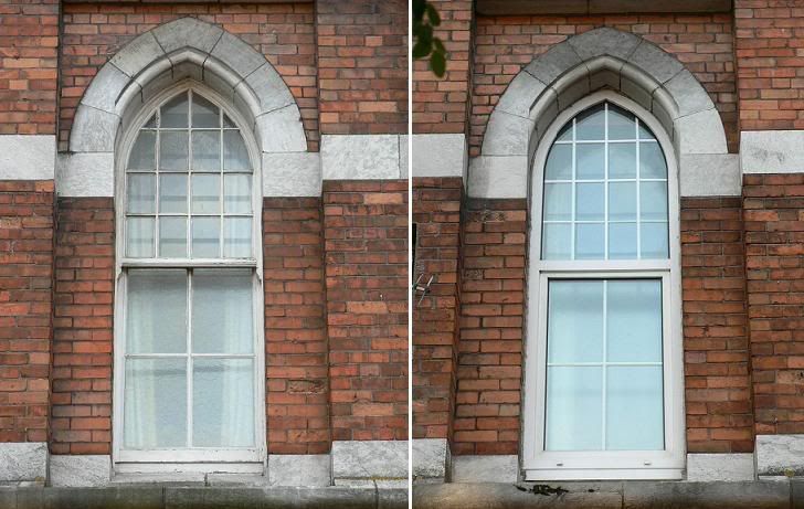

Postby corcaighboy » Fri Oct 06, 2006 5:40 pm
I took this snap back in August in Cork and it is somewhat depressing. The building in question is the VEC building on Paul Street, across from St. Peter & Paul's Chuch. The building obviously is quite beautiful but this awful PVC replacement job does it no favours. Looks both ugly and cheap.
<a href="http://imageshack.us"><img src="http://img183.imageshack.us/img183/4263/picturesfrompanasonic470ke5.jpg" border="0" alt="Image Hosted by ImageShack.us" /></a>

Re: Irish say no to PVC windows
Postby Devin » Fri Oct 06, 2006 7:41 pm
Ohh, that's a bad one! From a public body too ...

Postby GrahamH » Sat Oct 07, 2006 6:51 pm
I'm surprised these people don't line their interior walls with PVC panels to save themselves the hassle of 'maintenance' or redecorating every few years.
Different windows on the same Paul St VEC building, from last year:
